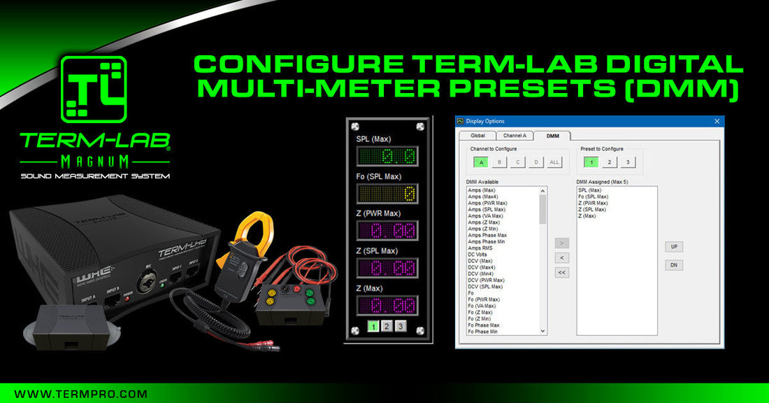

Term-LAB DMM screen showing SPL Max, Power Max, and Volts Max
How to Configure Term-LAB Digital Multi-Meter Presets (DMM): A Step-by-Step Guide

1. Open the DMM Configuration Window
The fastest way to open the DMM configuration window is by simply clicking on any of the DMM readouts. Alternatively, you can open this window by selecting "Tools / Display Settings" from the Term-LAB pull-down menu and then clicking on the "DMM" tab.
The fastest way to open the DMM configuration window is to simply click on any of the DMM readouts.
In this picture, 5 DMM readouts are enabled for preset 1.
The DMM configuration window is used to configure the DMM readouts
